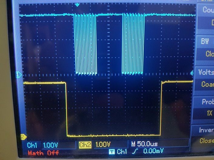

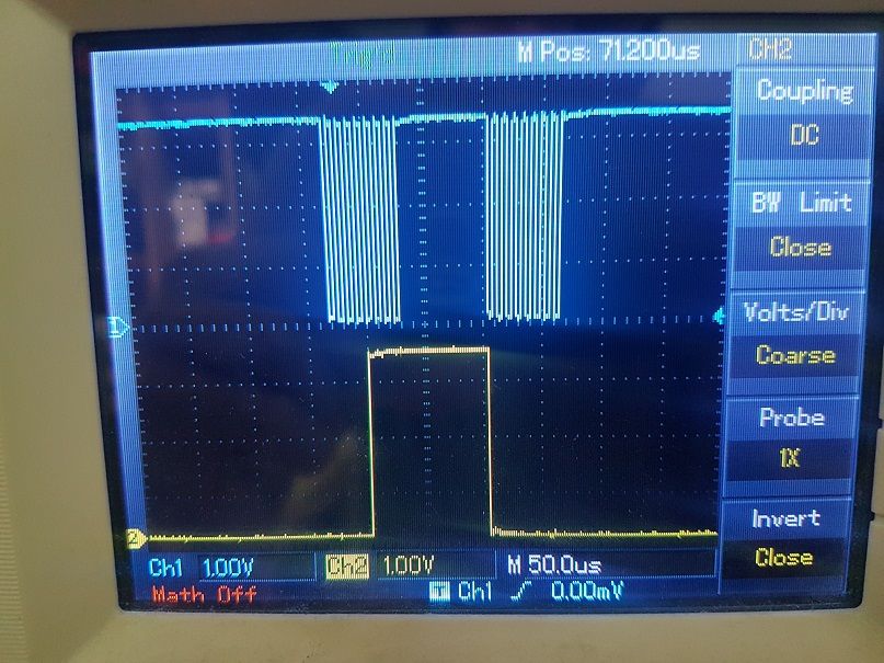

Hi @Yiftah​ , ok I understand... when you write >>SPI signals look fine in the oscilloscope, which is the pattern on SDO_Aux pin? Regards
Hi @Eleon BORLINI​ ,
SCLK (pin 3) + MOSI (pin 2):
SCLK (pin 3) + MISO (pin 11):
Best Regards,
Yiftah

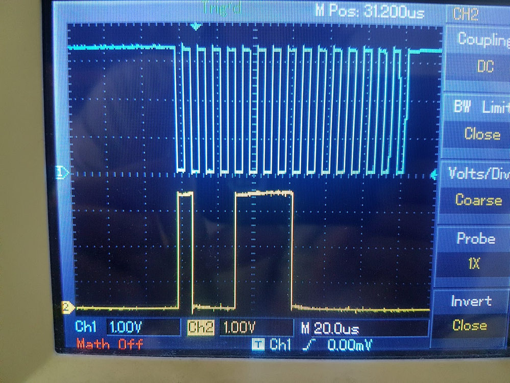

Hi Yiftah, also MOSI output seems not good... can you check the standard SPI communication between the master NUCLEO-G071RB and the slave STEVAL-MKI196V1? Are you correctly managing the CS pin? Maybe is not an issue of the aux interface but of the SPI at master level... Regards
This is the CS pin:
Hi @Eleon BORLINI​ , can you please give more details what exactly is wrong with the MOSI signal?
Yiftah

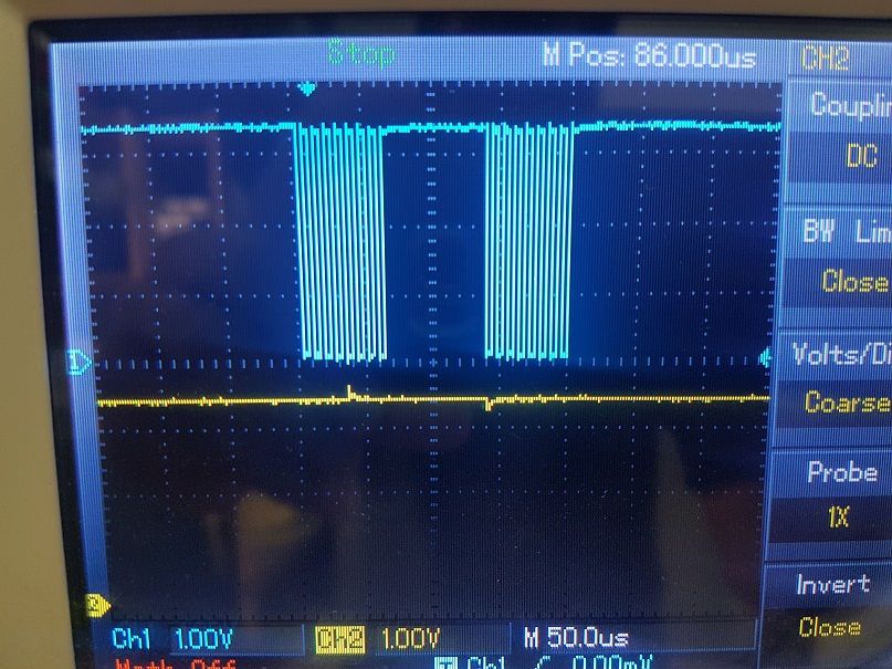

More information about the issue:
I noticed that in Figure 8 in the DS the first bit should be high for reading, so I added "| 0x80":
#define LSM6DSO_REG_WHO_AM_I  0x0F
while (1)
bufp[0] = LSM6DSO_REG_WHO_AM_I | 0x80;
status = HAL_SPI_Receive(&hspi1, bufp, 2, HAL_MAX_DELAY);
Now this is the MOSI signal:
But there is no change in the MISO signal - always HIGH :weary_face:
I also tried to disconnect the MISO from the master, connect only to the oscilloscope, and enable/disable the pull-ups with PIN_CTRL (02h); but MISO is not changing (with pullup - always HIGH, without pullup - always LOW).
