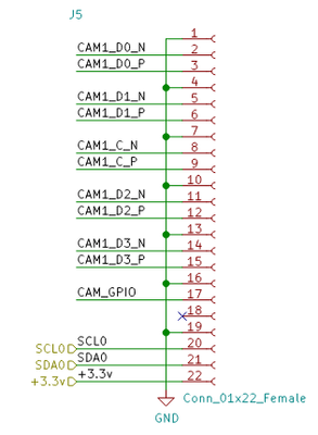

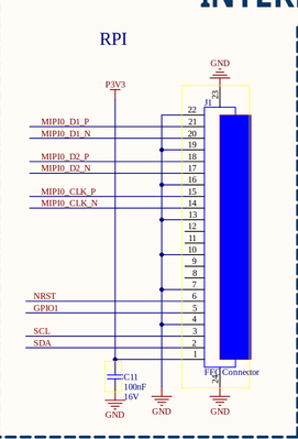

Hi, we are using the STEVAL-CAM-M0I board to evaluate the 55G0 protomodule.
I have it connected to a raspberry pi CM4 IO breakout board, to the CAM1 CSI-2 interface.
There is a provided driver, etc for this from ST, but it appears the pinout is not 1:1. But most of the documentation shows the eval board connecting directly to a raspberry pi. So I am wondering where does the issue lie here? Is the RST controlled by the GPIO, or am I missing something about the compatibility?
It was attractive because we didn't need to make an interface board.
I see the Reset pin and the Cam GPIO pins are swapped, along with the data lines. Raspberry PI Pinout:
and the STEVAL-CAM-M0I pinout:
Thanks

The two DTS folders in the provided driver, which are labeled "rpi1_to_4" and "rpi5" are not categorized by *pi type/generation*, as they are named. But categorized by *board type*. The generic Pi 1-4 boards share a 15 pin FFC connector with a specific pinout. The Pi 3/4 CM-IO breakout boards, along with the generic Pi 5 board share the 22 pin FFC with a different pinout. These are the two DTS categories.
If using the CM4 on the CM4 IO board (and also the CM3 and CM3 IO board), it shares pin compatibility with the Pi 5. So you must use the Pi 5 DTS, not the Pi 4. Which was my issue.

Yes, the camera board is fully compatible with the Raspberry Pi as mentioned in the documentation. Indeed, the reset is controlled by the GPIO. Regarding the swapped pins you mentioned, it will be fine if you simply swap the flex cable; it should be compatible.

Using the ST provided driver and device tree overlay, I am unfortunately seeing that the NRST line on the ST board is being held low by the CM4's CAM_GPIO pin. I must manually set it high in the terminal (`$ gpioset 1 5=1`) in order for the i2c communication to work and the driver's probe to be successful. It seems this is not handled automatically in this hardware configuration.
Has ST verified specifically with the Pi CM4 IO board? I think maybe there are hardware differences here in GPIO routing and pin usage, perhaps.
