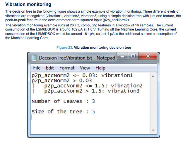

Hi Altamash, you could maybe select the threshold e.g. on the reg WAKE_UP_THS (5Bh) and generate the corresponding interrupts.
Btw, which is your target application? I warmly suggest you to check the LSM6DSOX machine learning core functionality (app note), that maybe fits better your requirements: this would allow you to create a decision tree to classify e.g. three different levels of vibration in the example below.
