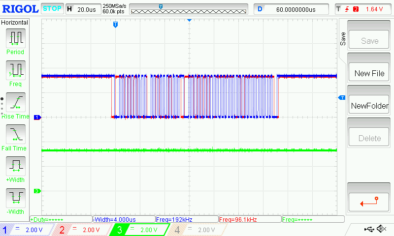

so I just managed to mirror the SCK and SDA lines to other Gpios of the nRF chip that are accessible.

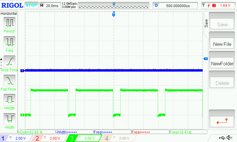

0693W00000Uob79QAB.pngRed is SDA, Blue is SCK and Green is Power of the LSM6DS3. Here the communication just works fine. But after the next power on of the sensor the lines keep being pulled low somehow... Even Powering the sensor off and on again doesn't change anything:
