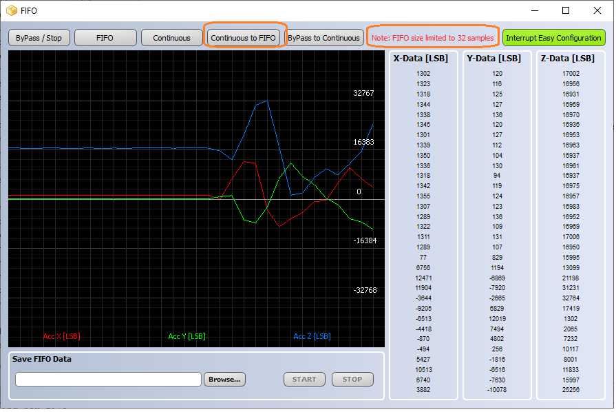

I am trying to configure a LSM6DS3 to capture Tap events in the FIFO similar to how Unico does.
i.e. I press "Continuous to FIFO" button (to enable a new capture), then tap the sensor, and the acceleration of the tap event appears on the screen (after being read from the FIFO).
0693W00000JN5aVQAT.pngI used Unico to derive my configuration. It is here in csv format:

With this configuration I expect that the FIFO will contain:
 * 32 accelerometer samples for each axis
 * contain the Tap Event
 * the timeframe immediately before the Tap Event.
I tried two different configurations (A and B)to achieve this by changing CTRL4_C, STOP_ON_FTH.
Note: I know that the Tap Event is working because I rout it to INT1, and use this to trigger the FIFO read.
Test 1, Configuration A (STOP_ON_FTH==0)
In configuration A, I think the FIFO is filling beyond the FTH. When I read the first FTH the data doesn't contain the tap event as if the FIFO is longer than FTH.
When I read FIFO status I see:
 Addr,Name,Value (hex), comment
 3A,FIFO_STATUS1,00,DIFF_FIFO_[7:0]
 3B,FIFO_STATUS2,E0,DIFF_FIFO_[11:8], FTH == 1, FIFO_OVER_RUN == 1,FIFO_FULL == 1,FIFO_EMPTY == 0
Why is this indicating there are 0 unread bytes?
Test 2, Configuration B (STOP_ON_FTH==0)
In configuration B, I think the FIFO is filling as soon as it is enabled, and then stopping upon sample STOP_ON_FTH. Obviously, this will not capture the Tap Event.
 3A,FIFO_STATUS1,60,DIFF_FIFO_[7:0]
I think FIFO_STATUS values make sense, but as described above the Tap Event isn't contained in the 0x60 words read.
It is difficult to decipher if Continuous-to-FIFO mode ever triggering FIFO mode to capture the Tap Event, or is the data I read the Streaming/Continuous (current) acceleration.
Why would Configuration A cause 0 unread bytes?
Is STOP_ON_FTH causing the FIFO to stop capturing new data as soon as Continuous-to-FIFO and 32 words are read?
Is the behavior I want possible? Can I limit the number of FIFO bytes to read in Continuous-to-FIFO mode by setting FTH?

 "So, basically the Tap event is not captured by the FIFO data, am I right?"
 ... This is correct. I found that the behavior I see is described in the App Note here.
<Snip AN4650>-------------------------------------------------------------------------------------
 8.2.4 Continuous-to-FIFO mode
 Continuous-to-FIFO mode is sensitive to the level of the interrupt signal and not to the edge, which means that if Continuous-to-FIFO is in FIFO mode and the interrupt condition
 disappears, the FIFO buffer returns to Continuous mode. It is recommended to latch the interrupt signal used as the FIFO event in order to avoid losing interrupt events (the interrupt
 signal has to be driven to the interrupt pin so that the latch function takes effect).
 </Snip AN4650>------------------------------------------------------------------------------------
Regarding:
 "Did you check you code with the Github C examples such as lsm6ds3_fifo_stream_to_fifo.c and lsm6ds3_multi_read_fifo.c?"
... I am using the code you referenced.
 It seems that, if I want to have unlatched interrupt (which I do), I'll need to adjust how I read the FIFO. I am considering using ISR on the falling edge of INT to guarantee the capture of the Tap Event.
