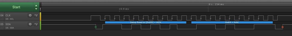

we are seeing wrong response for WHO AM I command,
SPI Configuration:
  • SPI Freq- 100KHZ
  • Slave Select - Active low
  • CPHA- 1
  • CPOL - 1
  • bit order - MSB first
sent 0x8F00 on MOSI line and seen 0x0040 and it was random some times we are seeing 0x007F as a response. can you please help us on this 0693W000008xcw8QAA.jpg

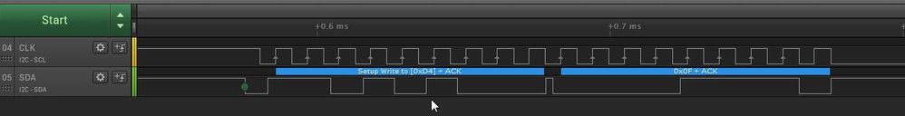

SChin.2
Hello @Eleon BORLINI​
As we see it is working fine with the I2C lines for reading the WHO AM I register, but as mentioned above it is not working as expected over SPI lines.
can we take this post to high priority please,
No clue from my side, unfortunately :( it should work from chip side...
You could try reducing the Vdd / VddIO values.
And you could also try writing the I2C_disable bit in the CTRL4_C (13h) register, that is a further insurance in disabling the I2C interface (could be useful in case ofin case of huge cross-talks).
You can try asking to the online support for more help.
-Eleon
SChin.2
found the root cause for it, MISO line is with high impedance , just need to place the resistance to avoid reflections on the line. In my case we have added 20ohms resistor is added.
