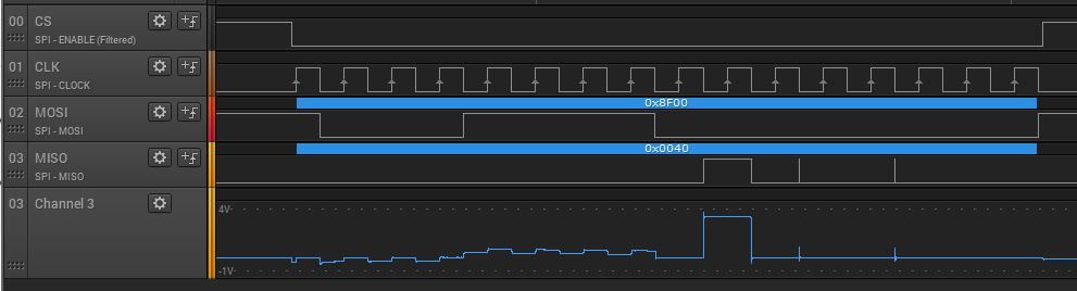

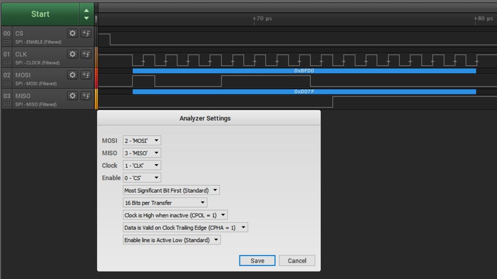

Hi ST
we are seeing wrong response for WHO AM I command,
SPI Configuration:
  • SPI Freq- 100KHZ
  • Slave Select - Active low
  • CPHA- 1
  • CPOL - 1
  • bit order - MSB first
sent 0x8F00 on MOSI line and seen 0x0040 and it was random some times we are seeing 0x007F as a response. can you please help us on this 0693W000008xcw8QAA.jpg

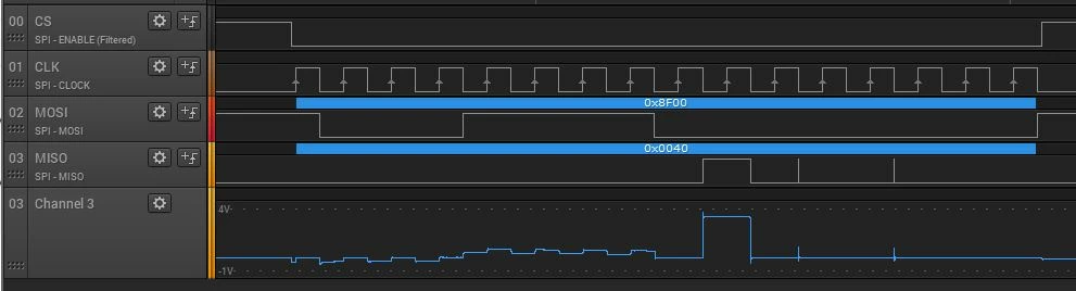

Best answer by SChin.2
Hello @Eleon BORLINI​
found the root cause for it, MISO line is with high impedance , just need to place the resistance to avoid reflections on the line. In my case we have added 20ohms resistor is added.

Eleon BORLINI
March 23, 2021
Hi @SChin.2​ ,
No guess so far, the CS, CLK and MOSI lines looks OK. MISO line and Channel 3 (I suppose it is the scope waveform). not so good...
For this reason, I'm wondering if it could be an "hardware" problem. Did you correctly set all the pins from the application processor side, and in particular the SCx and SDX pins, as stated in the datasheet p.9?
-Eleon

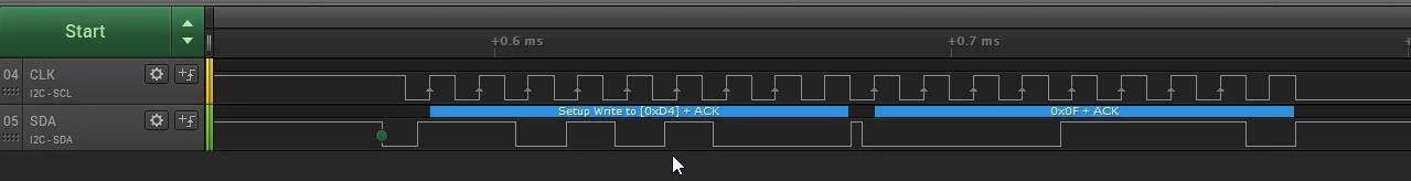

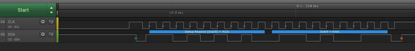

As we see it is working fine with the I2C lines for reading the WHO AM I register, but as mentioned above it is not working as expected over SPI lines.
can we take this post to high priority please,

Eleon BORLINI
March 24, 2021
No clue from my side, unfortunately :( it should work from chip side...
You could try reducing the Vdd / VddIO values.
And you could also try writing the I2C_disable bit in the CTRL4_C (13h) register, that is a further insurance in disabling the I2C interface (could be useful in case ofin case of huge cross-talks).
You can try asking to the online support for more help.
-Eleon
SChin.2
SChin.2AuthorBest answer
March 25, 2021
