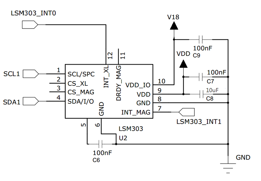

Hi, ST
    We met some problem when used LSM303C. We operated LSM303C go to power-down mode after the module power on .
Generally , the LSM303C current consumption is about 6 uA which is
consistent
with the datasheet e
lectrical characteristics
 table. But sometimes the
current consumption would increase to 48 uA after the module power on. And it seems that the acceleration module didn't work well for reading  a
ccelerometer Who_AM_I register to get 0x00 but not
 0x41.  What may cause this phenomenon. Please give us some guide advice.

Miroslav BATEK
Posted on May 22, 2018 at 21:01
Can you share your schematic?
Posted on May 23, 2018 at 03:57
hi,  Microslav B
    this is our schematic.
Posted on May 23, 2018 at 16:32
The CS_XL and CS_MAG cannot be let floating, for I2C communication they must be connected to VDD_IO.
