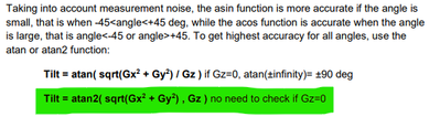

I am having issues with my acceleration data being output from my LSM303AHTR. I have configured it for 2G Full scale making the "sensitivity" 0.061mg/lsb.
I have tested two LSM303AH chips on two of our custom PCBs. I am getting similar results on both chips, but I am not getting the same exact values on both chips.
I evaluated all axis at +Gravity, -Gravity, and 0 Gravity. All of the expected 0 Gravity values are being seen, however, I am getting less than 90 degrees for positive and negative 1G positions.
My method for obtaining degrees from counts follows. I believe it is correct because it works for other projects' accelerometers:
Register Value * Sensitivity = mg
G = mg*1000
arcsin(G)
We can abstract out my method for obtaining degrees and just focus on counts. The issue still remains. When I am reading an axis that has full gravity exposure, I should be getting +/- 16,383 counts.
For X +1G I am getting -16,900 counts, which converts to 90 degrees, but this is slightly off scale.
For X -1G I am getting -15,750 counts, which converts to -75 degrees.
For Y +1G I am getting 15,750 counts, which converts to 75 degrees (just like X -1G).
For Y -1G I am getting -16,080 counts, which converts to -75 degrees.
For Z +1G I am getting 16,550 counts, which converts to 90 degrees, but this is slightly off scale.
For Z -1G I am getting -17,000+ counts which is greatly off scale.
Regarding my code, it is very specific and wouldn't make sense to anyone. I am shifting the MSB 8 bits and OR'ring it with LSB and stuffing that into a Signed Int. Again, we can talk about the conversion process, but all that really matters are the Counts I'm reading, which are not what is expected.

I was able to create an alternative heading vector using the atan2() equation mentioned in the last section of that document.
For people in future world, just plug in your mg values for x, y, and z where it uses Gx, Gy, and Gz respectively.
This will output radians, and you can convert to degrees by multiplying by 180/pi (57.296).
