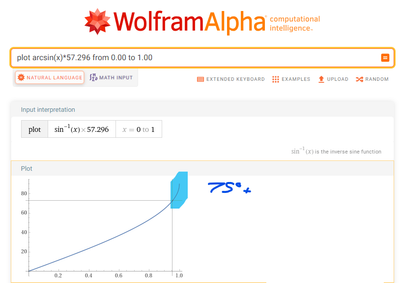

The problem is the logarithmic nature of how I'm deriving degrees. I am taking arcsin of g to get radians, and then multiplying by 180/pi ( 57.3 ). After 75 degrees, the output becomes more dramatic, and every mg of error heavily impacts the accuracy of the reading:
I will look into this 12mg error part, but even at 90 degrees, we are now talking about a potential error of 8-9 degrees:

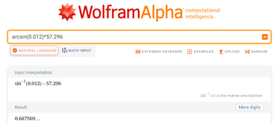

Furthermore, you are saying your margin of error on your 12mg part is 0.2 degrees, but according to the math we are using, your error should be +/- 0.7 degrees:

‎2023-07-10 11:42 PM
the idea is to rely on the other axis when one is too close to the 90 degree limit.
my solution is in fact the direct development of the design tip shared by Federica, so you can use that as a reference
hope this helps =)
