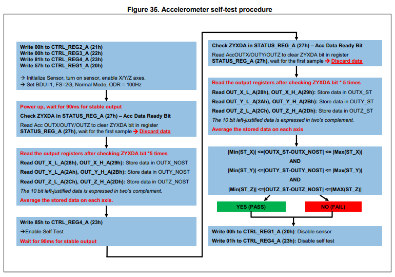

I am quite new to MEMS IMUs. I have a custom board containing LSM303AGR IMU connected to SAMD21 MCU via I2C.
I am using the stm32duino LSM303AGR library.
I am having a hard time understanding the Self test procedure. Is it possible to get a simpler procedural explanation?
Also,
1.Does self test require the device to be immobile?
2.Can I take self test readings in mg (GetAxes() method instead of GetAxesRaw()), if so what is ST_X/Y/Z limits in mg?
(from table 3 in datasheet is ST_X/Y/Z same as LA_ST?)
(according to datasheet LA_ST min = 17LSB max = 360LSB, 1LSb = 3.9mg , so multiply by 3.9 for mg?)
Thank you.

    Hi @MV.1​ , as a general note, did you already check the self-test procedure described in the AN4825, p.63 (or equivalently in the device datasheet)?
    As regard the two other questions:
    1.Does self test require the device to be immobile? --> It is better to perform the self state in a steady-state condition, but is is not necessary, because the self-test disconnect the sensor from the outer mechanical stimulus, giving the MEMS structure a predefined (high) signal.
    2.Can I take self test readings in mg (GetAxes() method instead of GetAxesRaw()), if so what is ST_X/Y/Z limits in mg? --> from the datasheet, the ST output for the accelerometer is in LSB, where 1LSb = 3.9 mg in normal mode (10-bit) at FS=±2 g.
    Regards

    Hi @Eleon BORLINI​ ​ , we are struggling to solve the accelerometer self-test constant failure. We were referencing AN4825 self-test routine flow. We are facing this issue on three different boards. Besides, results depend on board orientation. Could you assist?

    Eleon BORLINI
    May 26, 2020
    Hi @KLise.1​ , are you facing the issue always on the X axis or this is random? Did you discarded the 1st sample data as described in the flow? Regards
    KLise.1
    Visitor II
    May 26, 2020
    If the board is in one position, then only X-axis fails. If orientation changes, then it could be two axes fail or only Y-axis.
    Yes, as you can see in the code above.

    Eleon BORLINI
    May 26, 2020
    Ok thank you. Can you check your code with the lsm303agr_self_test.c C example for LSM303AGR, available on Github, if not already done? Regards

    Finally, I solved it! The problem was in bitwise operation. Should do
    int16_t temp = 0;
    temp = i2c_readbyte(addr, 0x28);
    temp |= i2c_readbyte(addr, 0x29) << 8;
    temp >>= 6;
    OUTX_NOST += temp;
    instead of
    OUTX_NOST += ( i2c_readbyte(addr, 0x28) | (i2c_readbyte(addr, 0x29) << 8) ) >> 6;
