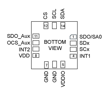

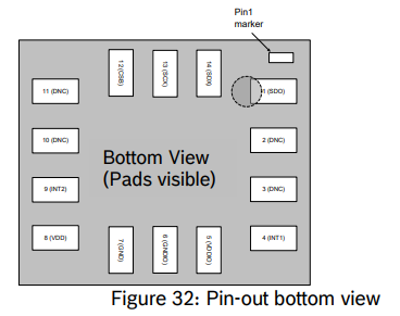

alternatively, you might consider the LSM6DSO(X) device (which is an IMU, so axl + gyro).
Both have the same package dimension (2.5mmx3mm, LGA 14L) and pinout.
Bosch BMG250, see datasheet p.60:0693W00000Y9vIVQAZ.png
ST LSM6DSO(X), see datasheet p.6:
You might need some minor software changes.
