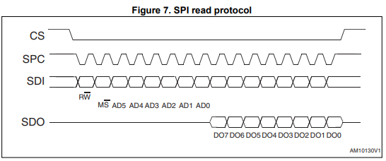

I'm trying to simply read WHO_AM_I (0Fh). OUT_Z_L (2Ch) and OUT_Z_H (2Dh) registers. But output data is only FFh. Also other registers too. What is the data sequence for simple read function? My SPI bus output is MSB first and clock idles low. For WHO_AM_I I'm sending 0F00h.
My schematic and SPI bus views is in the attachement.

May be I got it wrong about data type. Could you advice me please for WHO_AM_I or OUT_Z_H?
WHO_AM_I (0Fh) register value is 3Dh, while to see the OUT_Z_H varying try to enable OM[1:0] bits in CTRL_REG1 (20h). The SPI read protocol is the following one, so you have to send 16 clock shots and the SDI must contain the bit 0 (R/W) READ bit, which value is 1. For multiple readings the M/S bit has to be 1 too. SO you have to send the value 1F00h for WHO_AM_I reading. Regards
