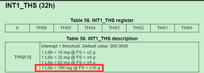

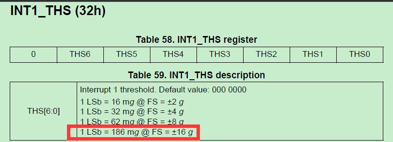

  3. From your settings I see you are in HR mode, you are right in shifting the value, but you have to multiply by the correct value according to your FS, as reported in table 4 on the datasheet.

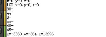

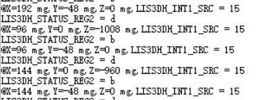

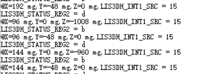

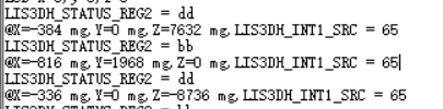

1. LIS3DH full scale is 16g, And it works in normal mode. The trigger threshold is set to 30, and the actual acceleration trigger value is 30*186mg = 5580mg. But when the trigger interrupt occurs, the output register is read and the output acceleration value is less than 5580mg. I think it should be greater than 5580mg.  When the threshold trigger occurs, will enter the data processing function (void  DealAccData(void)) ,the debug log is shown in the following figure:

    DEBUG_PRINT("LIS3DH_STATUS_REG2 = %x\r\n",st);
    uint8_t reg2;
    lis3dh_gvReadReg(LIS3DH_INT1_SRC,&reg2);
    lis3dh_gvGetAccData((int16_t *)&Var_giXMaxAcc,(int16_t *)&Var_giYMaxAcc,(int16_t *)&Var_giZMaxAcc);
    DEBUG_PRINT("@X=%d mg,Y=%d mg,Z=%d mg,LIS3DH_INT1_SRC
                                       %x\r\n",Var_giXMaxAcc,Var_giYMaxAcc,Var_giZMaxAcc,reg2);
2.  I think the conversion is correct because the test gravity acceleration is around 1g when the sensor is not moving.

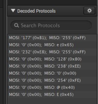

This is the captured SPI bus data and the data printed by the device
