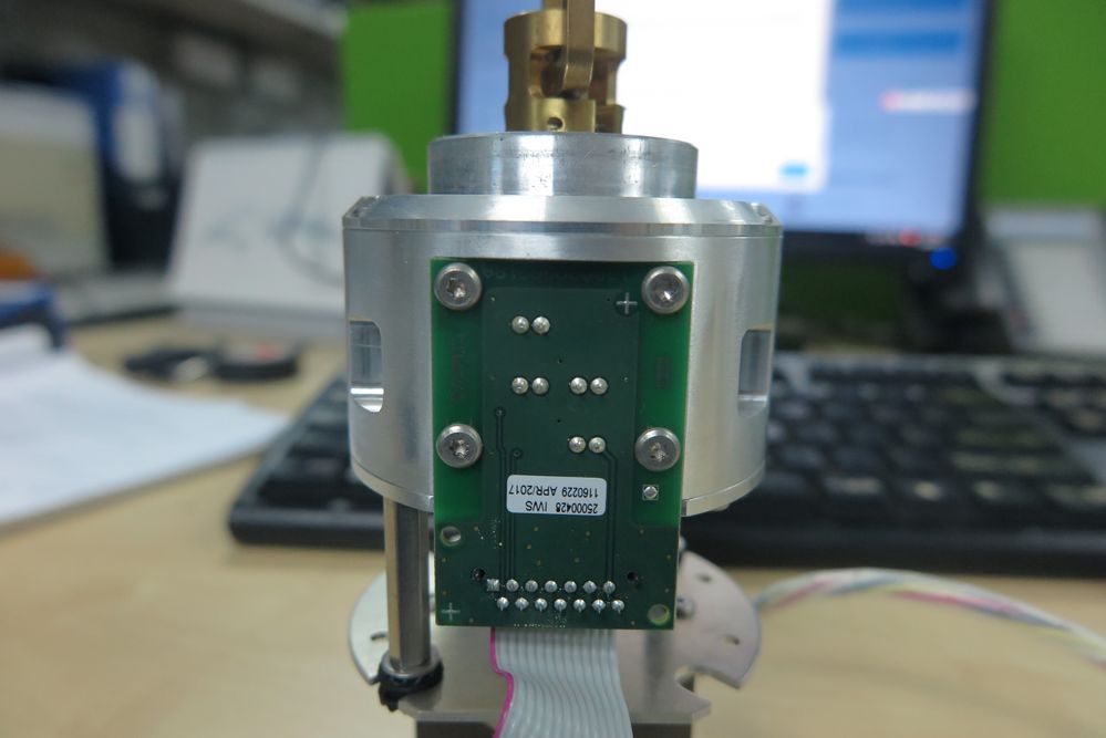

The LIS331 is adopte to measure device tilt, we assembled the PCBA in vertical positon and this means the sensor also works at vertical status. Please see the attached picture!

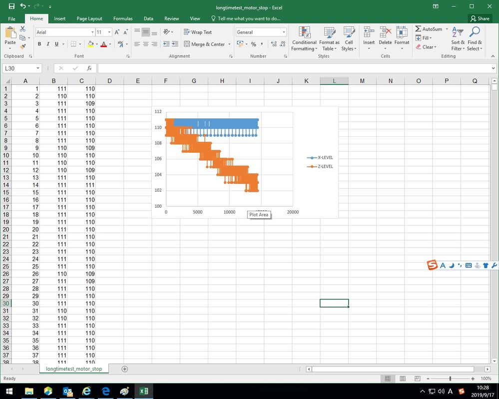

While we do test, we found that Z-axis output value will decrease step by step. Howerver the X-axis is quite stable. please see test data above. The test lasted about 3 hours.
Could you please tell me the reason?

Hi John, in order to understand if it's a device or setup related issue... did you check if the setup is stable (e.g. with a reference inclinometer, or rotating the pcb and getting the same values)? Is the temperature stable in the room? Is the X-axis stable? Looks like a ZGL drift...
Btw if you target application is to measure the tilt angle, my suggestion is to use the IIS3DHHC device, which is dedicated exactly to this purpose.

Not only the device on my desk has this issue, many customer also feed back that has the same issue. So I don't think it a set up stability problem.

​Hi John, if the drift is device-related, it could be due to the temperature or the mechanics (maybe MEMS-related). If it is a temperature drift, you can apply by SW the datasheet Zero-g level change vs temperature, i.e. 0.1mg/°C. If it is a mechanical drift, you should check if it's repeatable. if so, you could apply a negative gain vs time in post processing. Btw, which are the measure units of you excel file? Regards
