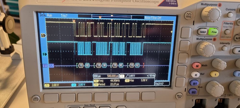

‎2021-04-20 1:17 AM
Hi Eleon,
LIS2HH12 is not part of our design anymore, because it had 0 stock.
Now we are facing the same stock issues with IIS2DLPC but it should still be in production.
I tried many formulas but the result didn't make any sense.
That is why I moved to scope measurements to be sure it is not a software issue.
On ambient temperature the IIS2DLPC replies with 0230h, and when I hold my finger on the chip I see register 0E increasing to 05, 06
Does manually heat solder this chip easily damage the internal temperature sensor?
Or did I maybe forget to configure the chip properly?

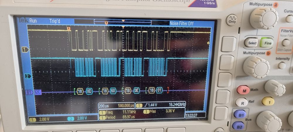

‎2021-04-20 4:19 AM
Hi Eleon,
I connected a Accel Click board to our device (https://www.mikroe.com/accel-13-click)
These boards are professionally reflowed and is on a different address.
So also very high temperature and fluctuating heavily.
