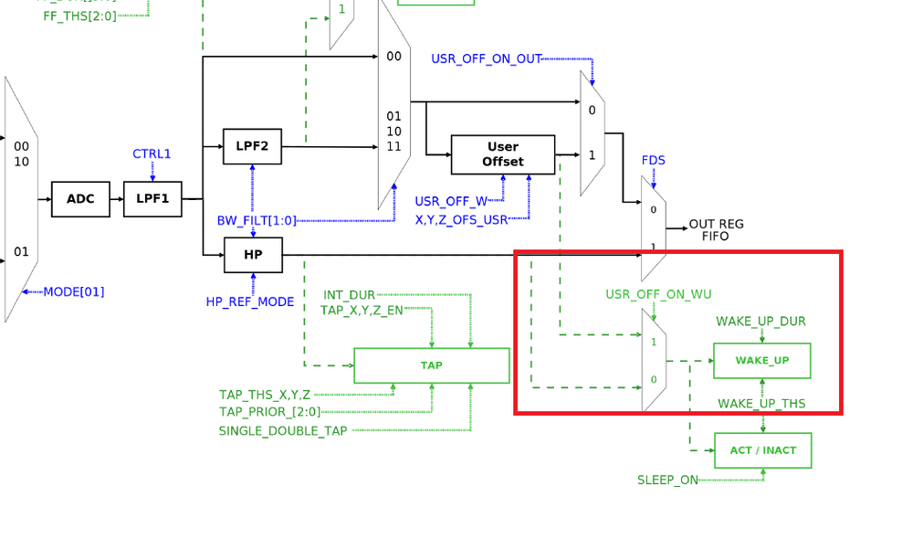

I didn't have continuous WK interrupt because USR_OFF_ON_WU was set to 0 so the filter path for the wake up function was high pass even if FDS was 0.

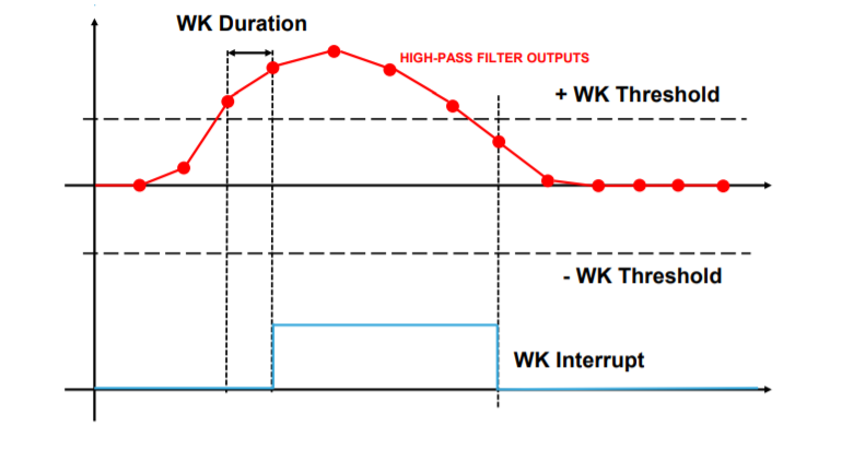

Hi Riccardo, you don't have continuous wake up triggers on INT1 since the interrupt rises when the 31.25 mg threshold is down to up crossed (for a specific duration), as shown in the picture:
See the app note https://www.st.com/resource/en/application_note/an5038-lis2dw12-alwayson-3d-accelerometer-stmicroelectronics.pdf
You might apply the HP filter if you want to rule out the 1g gravity constant acceleration.
