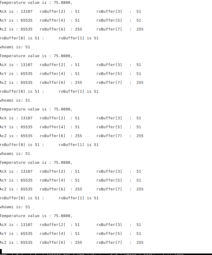

​Hi, to check the I2C communication did you try a single read of the WHO_AM_I (0Fh) reg? You should get 33h value. Consider that the factory calibration are stored in the reserved registers 00h-06h and could be 00h. Another point is if you are using the I2C multi-read sequence according to ds specs? Its very strange you see only one axis well (maybe only MSByte)... Better if it is possible for you to share the oscilloscope screenshots. Regards.
LN
Hi, Thanks for your quick reply. I tried reading the OFh Register But as you can see it's returning 51(integer).
Since I don't have an oscilloscope, I'll check and share you the screenshots shortly. 0690X000008wFDbQAM.png

and with this code:

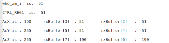

Eleon BORLINI
Did you correctly initialize the reg CTRL_REG1 (20h) in terms of ODR value? Lçet me pls know if you succeed in correctly reading the data. Regards
LN
Yea I have set CTRL_REG1(20h) to 57h i.e. 0101 (100Hz ODR) but still Accel x,y,z, values never changes.
Code:
