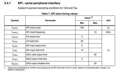

What is the maximum data transfer rate over the SPI interface for the LIS2DH12 accelometer? The datasheet doesn't say anything about this. About the I2C interface it is said that it can operate in standard mode (up to 100 kHz) and fast mode (up to 400 kHz). But nothing is said about the SPI interface.

Hi @MykolaLevun ,
Please refer to page 13 of the datasheet:

Thank you!
