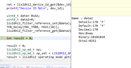

I am using LIS2DH12 with SPI connection.
I am able to read back Device ID which is 51. Also, I can write a to the reference register and read back successfully.

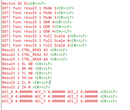

However, I cannot set registers. I am writing value on it and read back. The value on the register does not change.

The output of the program is like
I am running SPI with the following configurations;
1MHz Clock speed,
SPI Clock polarity active low, Sampling rising edge.
Could you help please to figure out my problem ?
 Also , why I am receiving same ACC value ?

Hi @ESims.2​ , can you please explain me the initial part of your code, for my better understanding?
uint8_t data= 0xAA;
uint8_t data2=0;
lis2dh12_filter_reference_set(&data);
TMR_Delay(MXC_TMR0, MSEC(10));
lis2dh12_filter_reference_get(&data2);
Which LIS2DH12 register are you reading?
