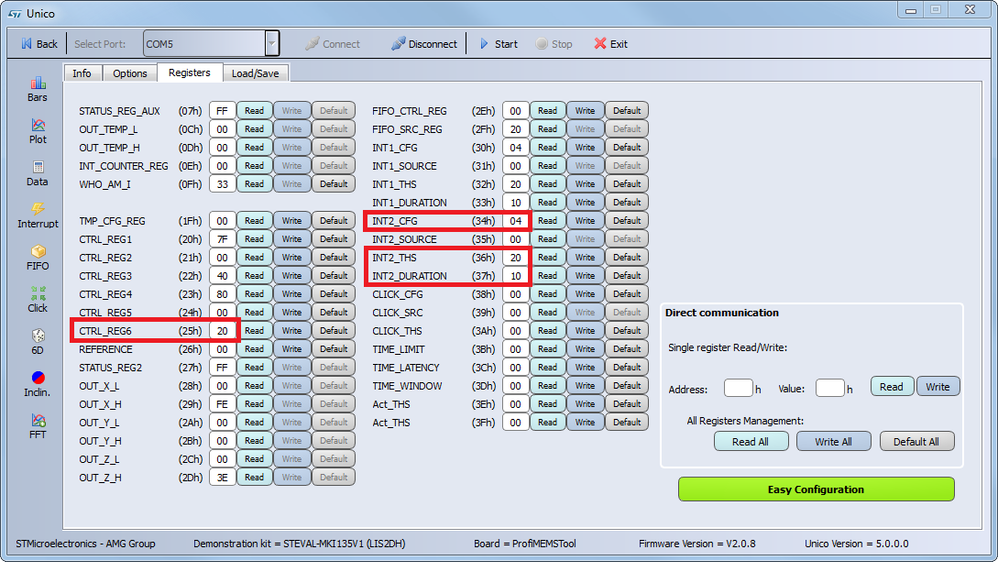

Since we had problems with the INT1 pin, we decided to use the INT2 pin to send interrupts to the PIC. Can you please tell me an INT2 registers configuration of the accelerometer that you are sure it's going to work?
We need that when we move a little the board where it is soldered the accelerometer, it will trigger the interrupt on the INT2 Pin.
P.S.: I tested the interrupt routine on the PIC to make sure that it is working when triggered, so now it is only an accelerometer settings problem.
Thank you very much for the help, I hope that this thread isn't going to be ignored
‎2017-03-10 2:30 AM

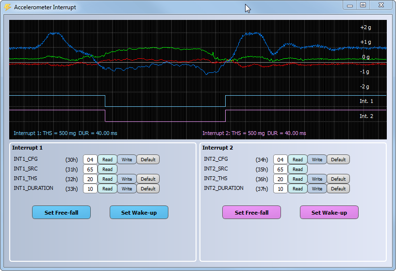

Please see below configuration of LIS2DH. The registers related to INT2 and Interrupt generator are highlighted.
Please adjust the threshold and duration parameters according to you needs.
Here is an example, showing functional interrupts.
‎2017-03-10 8:32 AM
Thank you very much, I will try it the sooner I can
‎2017-03-15 3:22 AM
I tried your settings and the interrupts are working now.
