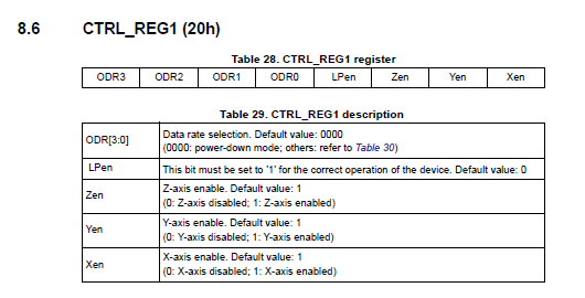

Posted on October 12, 2017 at 10:24
According to the datasheet the ''LPEN'' must be set to 1.
You should write 0x5F in the REG1, as I understand it.
I hope it will help you, but as it's not working for me I doubt.
Denis

I've got it working!  Using the settings below, when I read the INT1_SRC register I can see the bits changing as I move it around, and if I either leave my processor interrupt pin floating or pull it low, I will get an interrupt from the LIS2DE12 on the INT1 pin when motion occurs.  Reading the INT1_SRC register clears the interrupt until motion occurs again.  I hope this helps!
write_register_value(CTRL_REG1, 0x5F); // Turn on the sensor, enable X, Y and Z, ODR = 100Hz
write_register_value(CTRL_REG2, 0x00); // High-pass filter disabled
write_register_value(CTRL_REG3, 0x40); // Interrupt activity 1 drive to INT1 pin
write_register_value(CTRL_REG4, 0x00); // FS = +/- 2g, disable BDU
write_register_value(CTRL_REG5, 0x0C); // Bits D4D_INT1, LIR_INT1 - 4D detection enabled (requires 6D bit on INT1_CFG), Interrupt 1 pin latched, must read INT1_SRC (0x31) to clear it
write_register_value(INT1_THS, 0x16); // Very low threshold, 0 = default
write_register_value(INT1_DURATION, 0x03); // Minimum event duration
write_register_value(INT1_CFG, 0x7F); // All except AOI bit
write_register_value(FIFO_CTRL_REG, 0x00); // bypass mode
