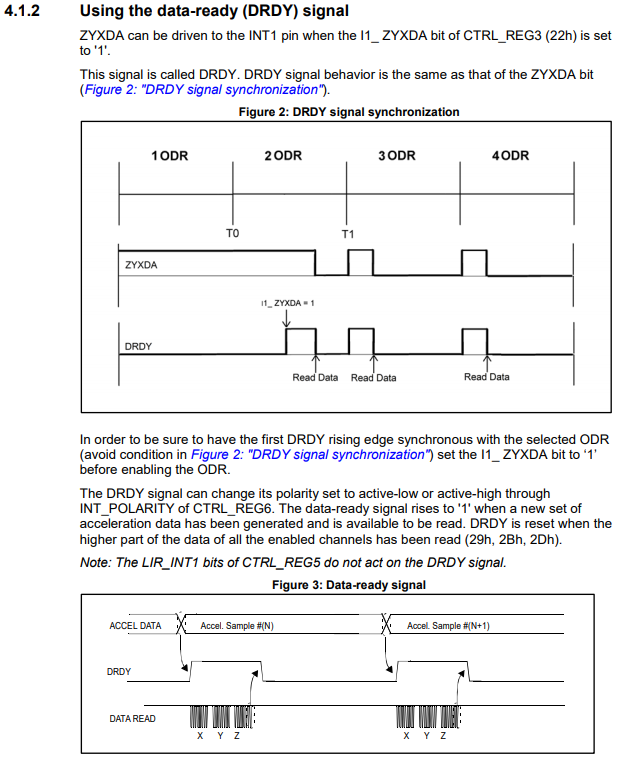

I configured the device and I am able to read XYZ data by polling the status register 0x27 and reading data when it is ready. I read more than 32 samples of each.
Here are my steps to read data that works:
Read register 0x0F - 0x33
Write Control register 1 - 0x07 // I can enable interrupts in register 3 before setting ODR
Write Control register 2 - 0x00
Write Control register 3 - 0x00 // Interrupts need to be set before ODR
Write Control register 4 - 0x00
Write Control register 5 - 0x00
Write Control register 1 - 0x3F // Lpen and ODR.
Loop: Poll Status register and read 6 bytes with with 0xA8 (0x28|0x80)
Now I want to use the DRDY interrupt and it is not working. I have confirmed that my interrupt code does work by externally pulling the line high. I enable my interrupt code before setting I1_ZYXDA bit in Control register 3. And per AN3308 I am setting I1_ZYXDA bit in control register 3 before setting ODR in control register 1.
Here are my steps:
Write Control register 3 - 0x10 // Interrupts need to be set before ODR
Write Control register 6 - 0x00
What is wrong?
thanks,
Kim

Hi Kim, it seems you did well in your code. How is the DRDY connected to the MCU?
Please also check carefully if you did everything is described here below. Regards
