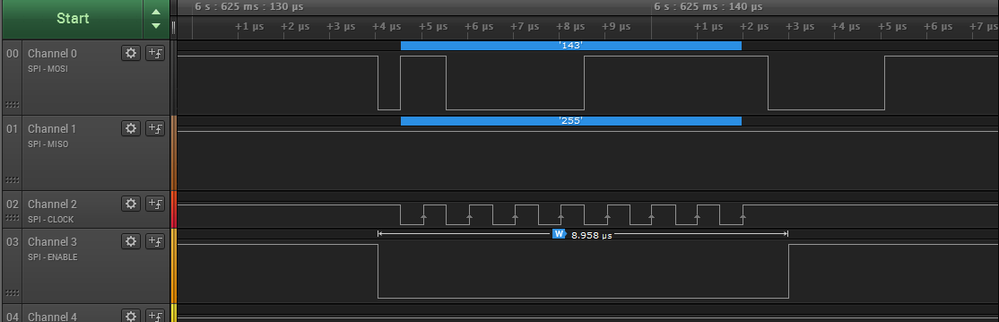

I am interfacing lis2de12 sensor with TI-CC2650 via SPI. When am trying to read the WO_AM_I register, it is returning 255 value when 0X33 is the expected value according to the datasheet. I have analyzed the protocol using analyzer and things seem to be fine there.
Below is the image showing data sent to be 143 i.e. 0X8F in order to read the contents from the WHO_AM_ register. Data received from the master is 255.

​I'm wondering if the TI-CC2650 SPI configuration are well set (e.g. 16 bit or 32 bit). Did you try TI-CC2650 SPI communication with other chips?
‎2019-09-09 4:08 AM
> And it worked perfectly when tested with Arduino example code for Lis2de12 utilising I2c.
Irrelevant.
It seems the sensor does not answer at all, the MISO line is just kept high.
Compare your analyzer result with the SPI signal section of the LIS2DE datasheet.
