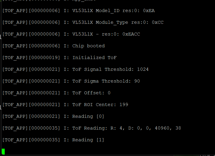

Hi ST Team,
I just integrated ULD driver of VL53L1X but it keeps returning range status: 4. What could be the problem?
Settings:
Timing: 100
Inter Measurement: 100
Distance Mode: Short
ROI: 16x16
Signal: Default ( 1026 something )
Sigma: 90
The I2C communication is tested to be working correctly and I’m successfully able to get all the reference register values. I don’t know why it keeps returning range status 4.

A status 4 is a "phase error". In order to detect something called Radar Aliasing, we actually do two ranges with different pulse repetition intervals. And these ranges do NOT return the same range.
I'm going to guess that if you use a larger target or a more reflective one, you will get a status = 0.
At whatever size and range you are using, it is past the limit of what the sensor can 'see'.
Moving in a bit will make the problem go away as well.

AShar.10
@John E KVAM​
Thanks for the quick reply!
I've tried different lengths ( 750mm ~ 250mm ) and target reflectances ( Marble, Black Tile, Hand, and Cloth ), In all of the cases it returns a range status 4 which is pretty weird, I've worked with VL53L0X in past and it was far reliable than this sensor.
Here's how the code is behaving ( I'm attaching my test code below :(
It tries to do 10 samples in a loop.
1st Reading: Range Status 4
2nd Reading: Stuck... It can't get the data ready flag again
Do you still think it could be due to radar aliasing?

AShar.10
Here's the output:
AShar.10
@John E KVAM​

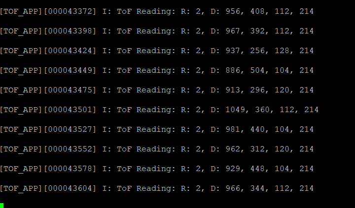

My bad! I took a look at my platform file again, the RdByte function was correct that's why I was getting all the reference registers correctly but I was overwriting the I2C buffer in some functions ( RdWord & WrWord ). Resolving that issue fixed this range status 4 error. Hurray!
Now I'm getting results with approximately correct distance but it's all range status "2". Can you give me some insight on what could cause this?
John E KVAM
Range status 2 is a:
"2 VL53L1_RANGESTATUS_SIGNAL_FAIL Raised if signal value is below the internal
defined threshold"
The status returns are in the API user manual which is delivered as part of the API when you download it.
Status 2 is the most common status when the sensor does not get enough photons to get a range. And it happens whenever there is no target, the target is too small, or the target is not reflective enough.
It's a good sensor but it's never going to spot knats at a thousand yards.
Place your hand in front of the sensor and slowly back up.
Use that data as sort of a reference.
Everyone is about 50% reflective at 940nm light, and for the most part hands are similar in size.
