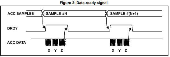

Please consider also this description you can find in AN4662 application note, p.14:
The data-ready signal rises to 1 when a new set of acceleration data has been generated and is available to be read. The interrupt is reset when the higher part of the data of all the enabled channels has been read (29h, 2Bh, 2Dh). If the output registers have not been read for a long time, a dummy read must be performed in order to clear the data-ready signal.

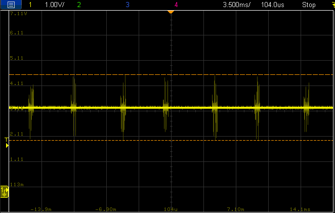

HTimm.1
0693W000003QfMqQAK.pngHello,
on scope i can see something on the interrupt pin.
But it is no clear signal.
After each SPI communication i do a pause.
The longer the pause the longer the spaces on the scope.

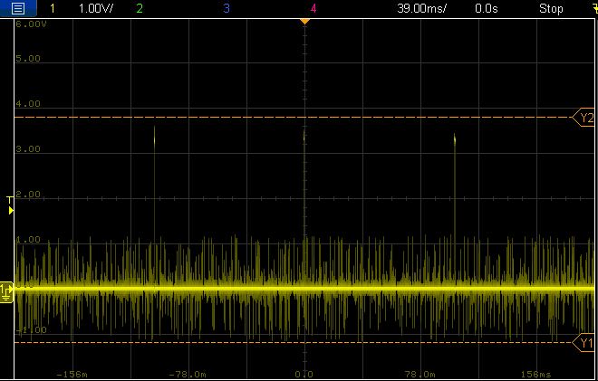

 Here i can see that the measure is done every 100ms (10 Hz).
INT1 does work. But the signal is very ugli for low signal.
HTimm.1
Now it does run.
The actual configuration is:
CTRL1 0x9F
CTRL2 0x00
CTRL3 0x01
CTRL4 0x06
CTRL5 0x00
CTRL6 0x00
CTRL7 0x00
Int1 does work. I do not know why Int2 does not work.
Also the signal Int1 is without disturbance now. (I do not know why)

But is the INT2 still not working also on the new LIS2HH12?
Thanks for your detailed report and regards
HTimm.1
I just did the test.
When i switch CTRL3 and CTRL6 the Int2 does fine on the new device.
It seems that my first device is buggy.
