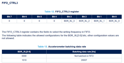

[iis3dwb] What are the units of the BDR_XL registor?
HKim.23
Adjusting the register values below seems to adjust the time at which data is written to the buffer.
I understood that the value is similar to Data Sampling frequency.
If i set the value to 6, about 1900 data per second will be written to the buffer.
I would like to know the exact units of that value.
3 REPLIES 3
Federica Bossi
Hi @HKim.23 ,
It is the batching data rate and the unit is Hz.
if BDR_XL is 0b1010, Batching Data Rate is 26667Hz.
Then, if BDR_XL is 0b0110, what is the Batching Data Rate?
Federica Bossi
Hi @HKim.23 ,
As written in the application note, the only two possible configurations are 0000 (default) or 1010 (26667Hz):
