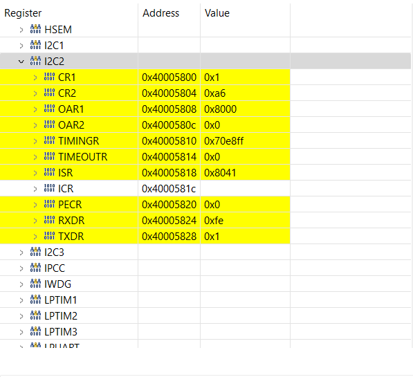

When I put my system on debug mode, following was the status of I2C registers. It shows me that BIT 15, i.e. BUSY is set in ISR. I have attached the screenshot.

Hi @Snatu​,
I'm not expert on this particular sensor, just see if the parameters from the sensor datasheets are met in your application. What is the connection between the sensor IC and the MCU? PCB or some loose wires? Pull-ups are applied externally?

Do you implement an I2C error recovery if SDA is low prior generating a Start bit ?
Example of I2C bit banging with error recovery here
