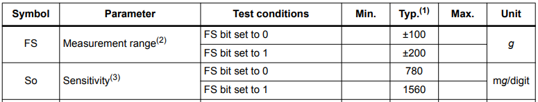

Could someone please let me know what units the H3LIS200DLTR Accelerometer transmits data in please
JMorr.5
We are having a few issues with the size of the numbers we are receiving so want to check the units are m/s.
Eleon BORLINI
Hi @JMorr.5​ ,
The output of the H3LIS200DLTR, for all ST accelerometers and sensors in general, is in digit, or LSB, referring to a Full Scale.
For the LSB to g conversion, you have to multiply the 8-bit output for the sensitivity that you can find on the device datasheet:
For the conversion formula, you can refer to the C examples on Github --> h3lis100dl_reg.c
float_t h3lis100dl_from_fs100g_to_mg(int8_t lsb)
  return ((float_t)lsb / 256.0f) * 780.0f;
-Eleon
