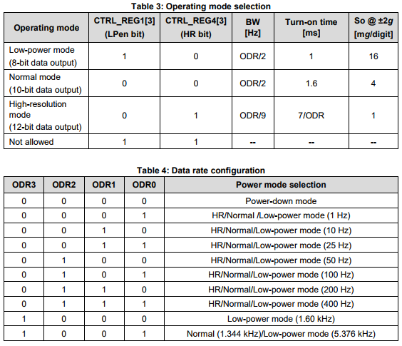

I am not understanding the concept of normal, low and high mode for the motion sensor IC LIS2DH12.
Can anyone please give me some idea about this concept.

and application note .The difference between low, normal, high mode is in data resolution, available ODRs and current consumption.
