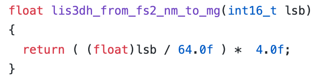

    On the other hand, I would like to know why in the LIS3DH project configuration and data reading in GitHub (drivers), for example to calculate the value read with 2g FS in Normal mode you do the following operation:
    I mean, I don't understand why you divide by 64 and multiply by 4. Wouldn't that be multiplying by 4000 and dividing by 65536?

    Hi @EEstr.1​ , this formula is a direct consequence of the info reported in the datasheet:
    • Full scale 2g --> sensitivity 4mg (p.10 of the datasheet);
    • Normal Mode operation --> 10-bit representation of the data (p.16 of the datasheet);
    So, to get the physical units from the LSB you have to undergo the following operations (e.g. for the X-axis data):
    1. OUT_X_H and OUT_X_L bit concatenation --> for example 2A50h
    2. conversion into int16 (it means you have to convert the 2A50h 16 bit value into signed decimal value via two's complement conversion)
    3. but your accuracy in normal mode is 10 bits, so you have to drop 6 bits --> or, equivalently, you can divide your 16 bit value for decimal 2^6 = 64
    4. finally, you have to multiply the value for the mg/LSB sensitivity --> 4mg/LSB
