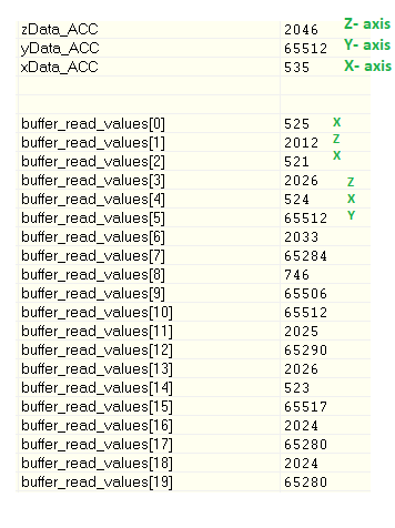

I will include a picture to to clarify the issue.
The 3 measurements at the top are the g-values (accelerometer) measured on the x, y and z axis. These are also indicated.
The bottom measurements are the measurements coming out of the buffer.
This way you can see that the buffer does not store every axis in order
0693W000000WtglQAC.png. But everything is mixed up. Because of this, in this case the x and z value are stored a few times before the y axis is stored once.
Hi, did you try to set the BDU bit in CTRL3_C (12h) register to block the data update if the specific axis is not ready (this can occur in case of high ODR)? Btw, on Github repository you can find some C code examples on the FIFO usage on ASM330LHH device, which has some commonality with the ISM330DLC. Regards
NJong.1
Yeah, I have set this one. But the BDU bit only concerns the FIFO readout and has no influence on the automatic storage of data.
Thank you for github link. I will check it.
