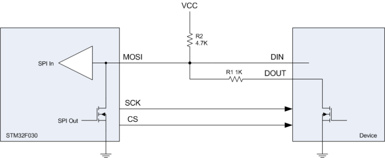

0690X000006DReOQAW.pngThe device is configured (by CubeMX) as half-duplex SPI (3 wires) since it was the only SPI option available for HTS221. I have one software NSS, a CLK and a MOSI (which is supposed to be switching role during a transfert).
I'm not sure to understand how a 4 wires interface would change something.
Would it be for this kind of architecture : ?
Thank you for your help.

As SPI 3 wires for HTS, try to short STM32 MISO and MOSI pins and use the mcu SPI in bidirectional mode. When reading data, simply turn MOSI as digital input pin to cut the peripheral from expressing its output data while sending SCK clock pulses.
If this works, then you can try to use the other SPI specifics modes of the peripheral.
And remember that the sensor listen to the lines as I2C slave when NSS is high. So if this SPI peripheral has multiple NSS on the MCU side, make sure signals are "clean".
