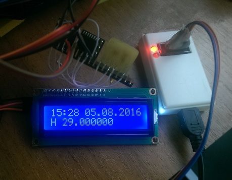

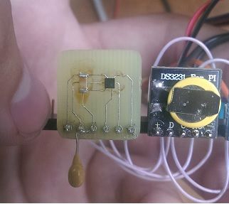

HTS221 after read all humidity registers final value always 29.0% and not changed in time. All data register contain 0xAE values. ST firmware driver for HTS221 also returned 29.0% and 0xAE registers values.
Connection diagram of the standard, according to datasheet
Tried several sensors, one and the same. sorry for my english.

Exchange with sensor tested, working, fixed identifier read correctly (188 or 0xBC) datasheet for both, but the data in the registers are not updated. Having tried all the options register settings. Always one and the same humidity of 29%. The temperature is also fixed. readiness Register reports that are ready the data as temperature and humidity. Apparently the defective batch.

Posted on August 05, 2016 at 12:39
Registers readiness show that the data is ready ! Fixed code , vseravno 29.0 humidity . And with the register read 0xAE. It seems that it is certainly broken sensors .
This party was sent probes to our company as a sample for review.
The amount of 3 pieces.
