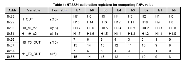

To be able to count the output, output values + calibration values are needed.
Please paste the content of all the registers below:

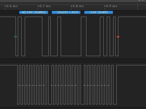

I2C analyzer's log when writting 0x20 register:

Posted on May 17, 2017 at 21:01
According to the formula provided in
http://www.st.com/resource/en/technical_note/dm00208001.pdf
 is and your H_OUT value is the humidity 143,3 % rH.
I believe H_OUT = 0x8000 is some default value to be overwritten by a first measurement (I have seen the same with other sensors).
Make sure your sensor is switched to active mode from power-down mode. The only thing to turn it on is to write a correct value to CTRL_REG1 (20h).
Can you trace your code to the point where the constants in the struct are combined (ORed) together and what value is written to that register?
Or even better, can you see what is written to that register by connecting a bus analyzer?

Posted on May 18, 2017 at 09:58
The configuration also seems to be OK, active mode, BDU and 1 Hz output data rate.
