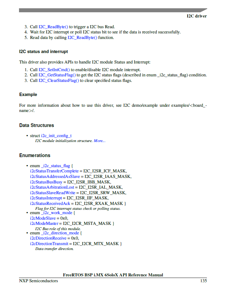

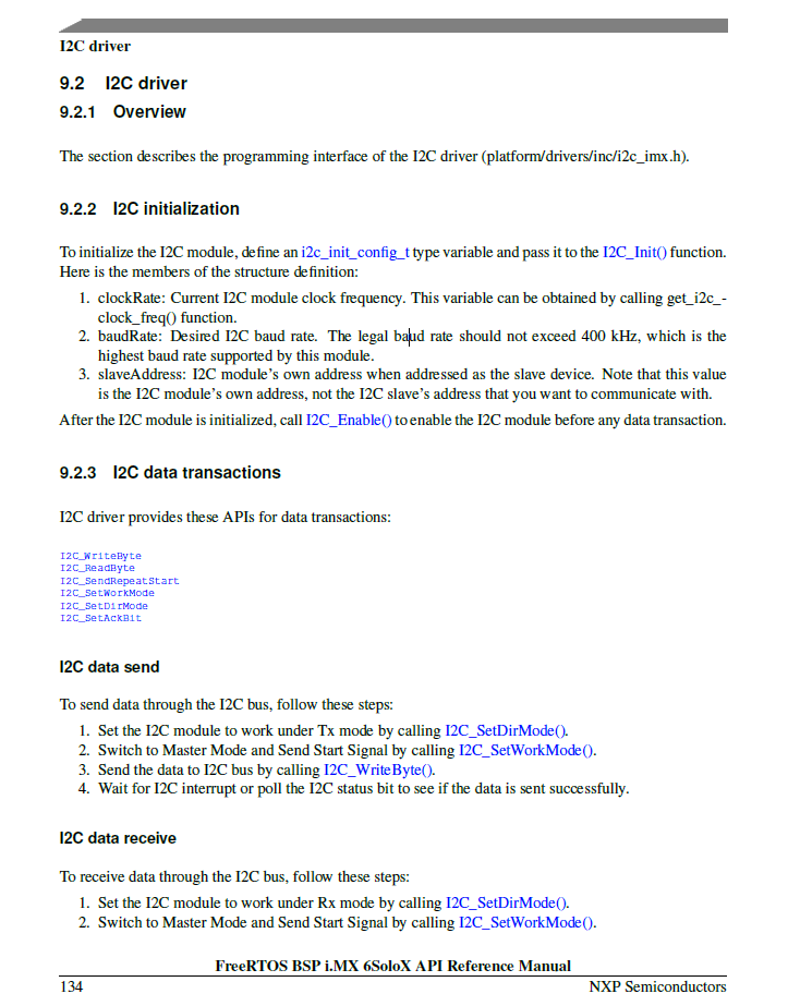

Thanks for answering. I see clearly the stuff I have to do, but I don't find any example helping me to develop the expected function. I've just found the API reference manual for the freertos BSP of i.MX6SoloX :

As I wrote above, I would focus on three things:
1) I2C initialization: that is exactly what you pasted in the reference manual in section 9.2.2
2) Read multiple bytes: that is just about writing a cycle to send more bytes via I2C_ReadByte as stated in section 9.2.3
3) Write multiple bytes: the same as for 2) using I2C_WriteByte
If you struggle with the FreeRTOS, try to ask for help on FreeRTOS forum. If you struggle with the i.MX device, try to ask on
. You would have to be quite lucky to find a help here, since your question roots are not in the sensor itself...- Mark as New
