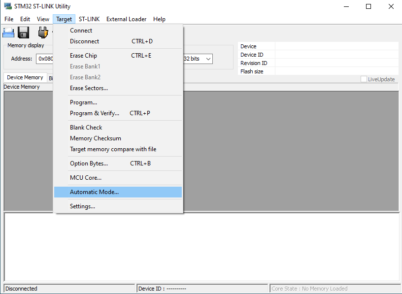

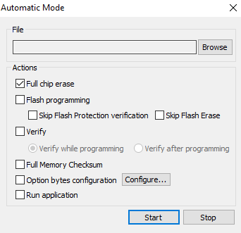

I am using STEVAL-STLKT01V1 kit for my project. i got the sensortile solered on cradle expansion. earlier i was able to configure it using stm32cubeprogrammer using readymade applications like audioLoop, etc. but now i don't know what have i done the device is not even recognized by st-link-utility or stm32cubeprogrammer. is it possible to reset the devices.

You can try running the “Full Chip Erase�? in automatic mode, as shown in the pictures below:
0693W00000FDb6vQAD.png0693W00000FDb70QAD.pngJust after having launched it, you unplug and then plug immediately the USB supply of the Sensortile.
The purpose is to make the ST-Link blocking the STM32 before the code execution starts. This procedure should lead to the reset of the STM32 chip.
-Eleon
