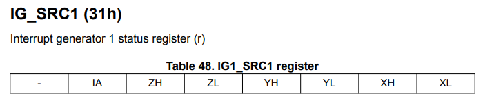

I set ACT_THS and ACT_DUR registers, so now the chip enters on low data rate mode (10 Hz) when no movement is detected. everything is fine to that point.
I don't have access to INT1 and INT2 pins physically so I need to read activity/inactiviy status by registers.

You might poll the IA bit of this general interrupt status register (see datasheet, p.39):
You'll clear the interrupt by reading this reg. This is a general purpose register, so you'll see here all the status of the interrupt you have set.
