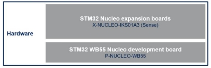

Hii can anyone help me with the code for hts221 temp sensor on stm32wb55 nucleo board with iks01a3 expansion board

Hi @Gk.1​ ,
There is the firmware function pack FP-SNS-MOTENVWB1 that should be designed for your purposes. This solution combines the P-NUCLEO-WB55 master board with the X-NUCLEO-IKS01A3 sensor platform in the hardware layer, enabling the sensor reading through the STM32WB55 microcontroller.
0693W000006EawXQAS.pngYou will find the application example in the project folder \Projects\P-NUCLEO-WB55.Nucleo\Applications\MOTENV1, after downloading the package. The specific drivers for the HTS221 humidity and temperature sensor are in \Drivers\BSP\Components\hts221, in the hts221_reg.c file.
You can find more details in the UM2613 user manual, p.24 for the hardware and software setup.
