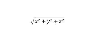

Thank you, and can we use below formula for calculate the amplitude value? Because these values are vector and we want to focused amplitude value.
Hi @ABulu.2​ ,
yes for sure, to have the spatial intensity you can use that formula.
-Eleon
