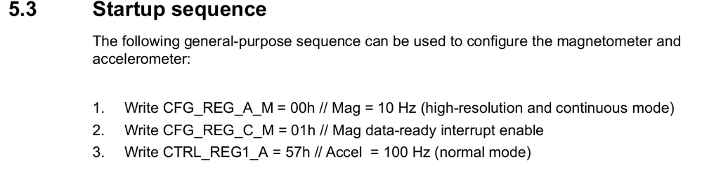

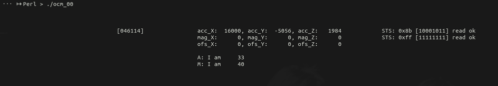

Actually I need to read acceleration and magnetic components using G071RB and LSM303AGR with STM32CubeIDE.
I tried to understand anything reading the Datasheet, but it is really hard (well, I am not familiar with such devices. I rather deal with different things usually). I managed to get proper who am I values, and reading the Acceleration components and their status register give some values (they change in time). The velues of magnetometer are constantly 0 and their status is constantly 0xFF, although the reading procedures git HAL_OK as output:
0693W00000GZJoAQAX.pngI did initialize the registers as it was suggested in Datasheet:
where HAL*feed_1B is:
That is why I decided to try to use some existing solutions. Alas that what I find here is not usable.
