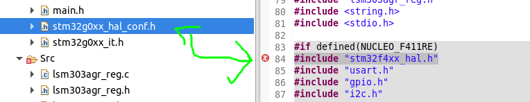

The first is, what shall I uncomment here:
0693W00000GXTgBQAX.pngMy board is nucleo-G071RB
Here
0693W00000GXTg1QAH.pngI do not see stm32f4xx_hal.h
Can you advice ??

To keep it clear, the example mentioned focuses on three typical platforms and clearly shows how to use it. But it also mentions directly above in the source code at line 47:
/* STMicroelectronics evaluation boards definition
 * Please uncomment ONLY the evaluation boards in use.
 * If a different hardware is used please comment all
 * following target board and redefine yours.
There are currently around 55 matching NUCLEO boards, so that the source text with all its options would be too confusing.
Your board NUCLEO-G071RB is very similar to the NUCLEO_F411RE, so you might use the conditional definitions
#if defined (NUCLEO_F411RE)
as a template and copy/change them to
#if defined (NUCLEO_G071RB)
Once you understand how the NUCLEO and the sensor work, it will be easy for you to make the changes.
Regards
/Peter

I did what you did and that does not work: [image: image.png] I do not see the *stm32f4xx_hal.h* file anywhere. should one not *#include* to avoid the last warning ?? pon., 15 lis 2021 o 08:33 ST Community napisał(a):

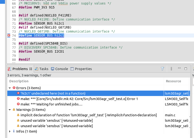

I did what you had suggested,. That is, I copied the fragments concerning NUCLEO-F411RE and changed them appropriately. In particular, there I got:
#include "lsm303agr_reg.h"
#include <string.h>
#include <stdio.h>
#if defined(NUCLEO_F411RE)
#include "stm32f4xx_hal.h"
#include "usart.h"
#include "gpio.h"
#include "i2c.h"
#elif defined(NUCLEO_G071RB)
#include "stm32g0xx_hal.h"
//#include "usart.h"
//#include "gpio.h"
//#include "i2c.h"
#elif defined(STEVAL_MKI109V3)
#include "usbd_cdc_if.h"
#include "gpio.h"
#include "spi.h"
#include "tim.h"
#elif defined(SPC584B_DIS)
#include "components.h"
#endif
It turned out that without commenting out the lines 14-16 above I got messages that the h-files do not exist.
This however did not help, for after that I get the error:

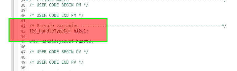

Well, the variable hi2c1 is defined here:
0693W00000GY4NuQAL.pngin main but but it is not seen in the very example function .
I do enclose the ZIP with the whole src directory. please make necessary corrections and share.

Sorry, I didn't see a question other than a request to correct the code. However, rarely someone will change the given code here, but will give hints on how to do it yourself.
However: if the compiler cannot find the .h files, they are not included in the project. In your case, this is due to the fact that you probably created the frame program with STM32CubeIDE, whereby the default setting in the Project Manager ensures that the code for all peripherals is put together in one main.c/.h. If you check Generate peripheral initialization as a pair... in Project Manager > Code Generator, you will get the .c/.h files you are looking for, e.g. gpio.c/.h, i2c.c/.h, etc. But every programmer does this the way he likes it and in your case it is not absolutely necessary to change this setting, just leave the missing .h files commented out.

And you did not answer the last question. What with the variable hi2c1 ??
Just read carefully what - I asked about that at the very end.
