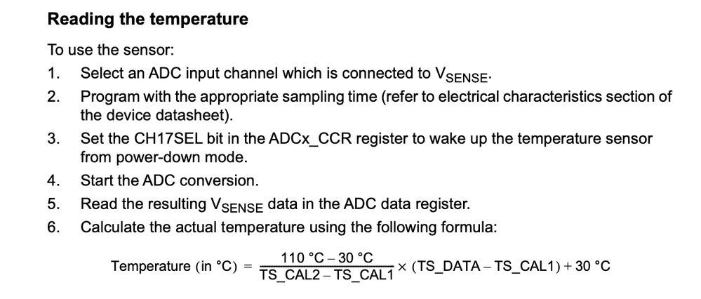

This is the reference manual of the chip I use. The temperature sensor is internally connected to the ADC input channel which is used to convert the sensor’s output voltage to a digital value.
The temperature reading steps are listed as in the picture according to the reference manual
This would be the die temperature of the STM32L4. Couple of calibration points are stored as words in the ROM/OTP memory.
You're scaling and rebasing, given an 80 degree (temp) slope and the value read from the ADC. Secondary school math I'd suppose.
Try feeding in TS_DATA (ADC) values of TS_CAL1 and TS_CAL2 and confirm you're understanding by pulling out the expected temps.
