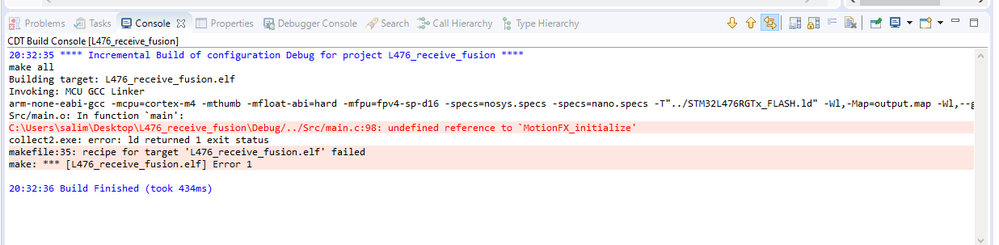

Hi everyone, I'm trying to use the library MotionFX from STM32CubeMX, but i have a problem when i try to build the project on SW4STM32 see below details. please can someone help me to find a solution? Best regards thanks
salim

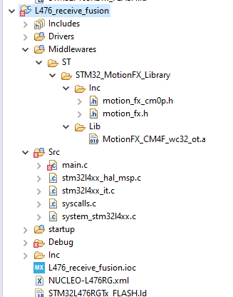

Please check the path to motion_fx.h is in your include path (in project settings).

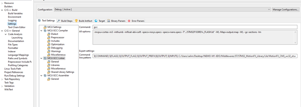

It's not a problem with .h include path it's a problem with preprocessor Incluide Paths for library,
my solution is to add path of the library (.a) in the "Expert settings Command line pattern" and it's work.

You can add the library also in the Libraries settings in the Linker section, so you don't need to write the command.
When i try to add it with the "Linker section method" it's not working.
