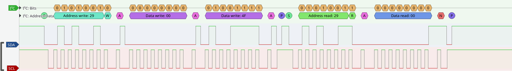

I am in process of interfacing an Attiny85 (not Arduino) with a VL6180X board (with I2C level shifter built-in).
I wrote my own I2C master interface (USI) and I am able to successfully to get the VL6180X work in a single shot mode (after many hours of struggle).
I spent a lot of time wild geese chasing due to VL6180X "pretending" to respond correctly to some of the register read/writes but not being able to actually read the actual distance until I moved the whole thing to battery power (adding additional capacitors to 2.8V or 3.3V supplies didn't help).

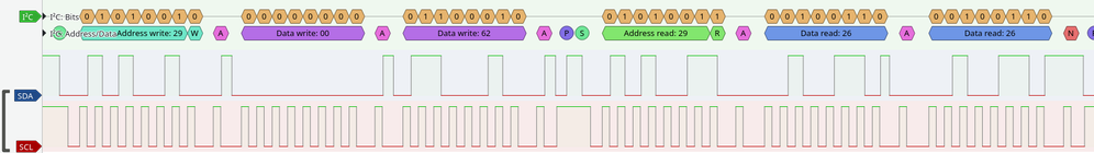

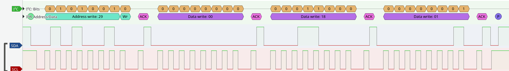

One thing that lead me astray was the fact that I never bothered to check the actual contents of the 0x0062 register after setting the 0x0018 register, as I was following somewhat scarce documentation and polling the 0x004f register for a ready bit set (as per the application note):
Poll RESULT__INTERRUPT_STATUS_GPIO {0x4f} register till bit 2 is set to 1

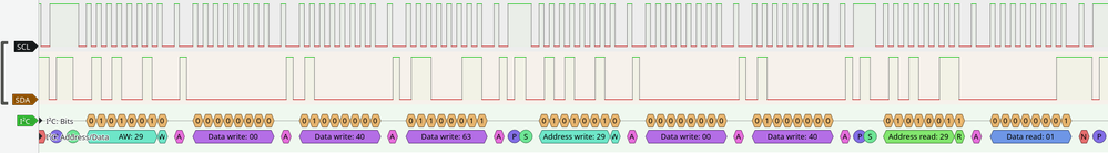

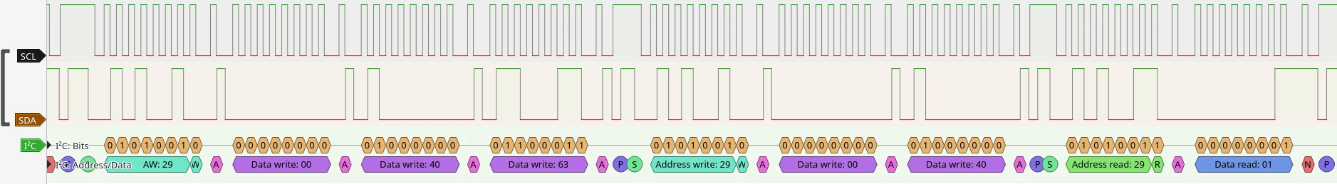

Now I suspect I am not setting some kind of result threshold thus the problem. I followed the application note as much as I could including the SR03 Settings section and set all the undocumented "Mandatory" registers and "Recommended" including this:
WriteByte(0x0011, 0x10); // Enables polling for ‘New Sample ready’
 // when measurement completes
I also set the "Optional" registers one of those is this:
WriteByte(0x0014, 0x24); // Configures interrupt on ‘New Sample
 // Ready threshold event
Have I missed anything else?

setting 0x0018 registersetting 0x0018 registerreading 0x004f registerreading 0x004f registerreading 0x0062..63 registersreading 0x0062..63 registers

I believe I figured out my problem.
I was not setting register 0x0014 (SYSTEM__INTERRUPT_CONFIG_GPIO) to 0x04.
Since then I get two things happening:
  1. GPIO1 being pulled down when the sample is ready (very neat).
  2. The register 0x004f is set.
Not sure if I have enough pins on ATTin85 to use the physical GPIO1 as interrupt, even if not, now I can poll 0x004f instead of sleeping for 200ms.
Interestingly enough while I was debugging (I read every register I set) this I noticed the ALS integration time register setting didn't stick (I don't care about ALS). This sent me to read dt0037-vl6180x-range-and-ambient-light-sensor-quick-setup-guide-stmicroelectronics.pdf which had a neat flow chart that mentioned setting register 0x0014.
