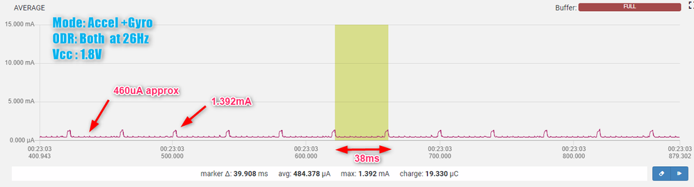

Currently, we are seeing a constant current pull off 460uA with a peak current of 1.392mA for every 38ms Approx. Can you confirm the above measurement which we are seeing? and it would be great if you recommend any other way to reduce the current pull down further.

Hi @PRaji.1​ , I assume you are reading the data with SPI or I2C protocol every 26Hz (i.e. 38ms), right? It seems that your measures are reasonable. To reduce this current consumption you should act on the communication event, for example reducing the SPI speed, or increasing the pullup resistors value in the I2C case. Which is your current communication protocol speed? Regards

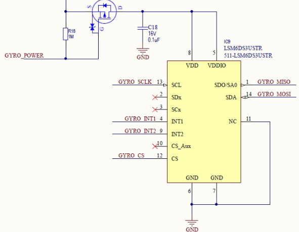

Yeah we use SPI Protocol. The SPI Communcation speed is at 8MHz (Works well for all other ST Chips). Yeah, we are bit concerned about measures there because, the 1.392mA for every 38ms and 460uA is draining our battery as the sytem measure the Accel&gyro 24 x7 hrs.. The peaks go further down if we enable the Accelerometer alone mode. We are using NRF52 Power Profiler for current measurment protocol software and it has 77KHz Sampling rate. 0693W000001cMKhQAM.pngThe above is the application circuit we use. Any recommendation on the application circuit is appreciated.

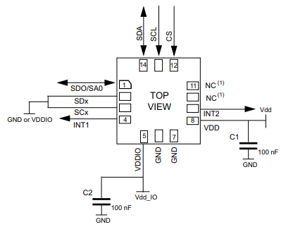

A comment also on the connection, as reported in the datasheet application hints (p.41):
The SDx and SCx are connected to a fixed voltage, Vdd or GND, while you are leaving them unconnected. I'm afraid they could someway affect the overall current consumption...

Just to update on this. As you suggested, We have connected SDx to SCx to GND and we are still seeing the high current peak at every 38ms. Would it possible for your team to replicate the issue.
