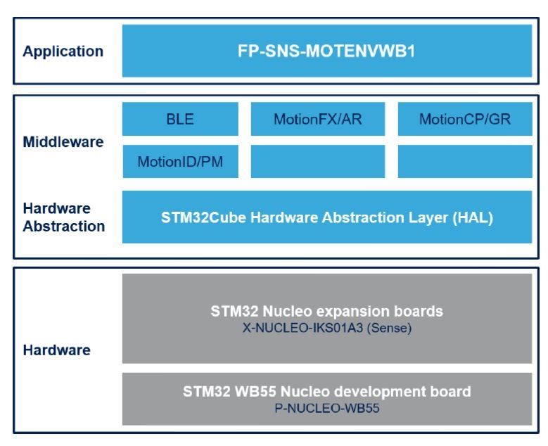

Hello, is it possible to work with unicleo GUI using an STM32 WB55 ? because i tried and it wouldn't even connect, thank you,

Hi @NAsma.1​ ,
yes it is possible. Please check if you are using the following tools:
- Hardware:
- Motherboard: P-NUCLEO-WB55
- Daughterboard: X-NUCLEO-IKS01A3
- Firmware: FP-SNS-MOTENVWB1
You can find more info in the FP-SNS-MOTENVWB1 online page.
