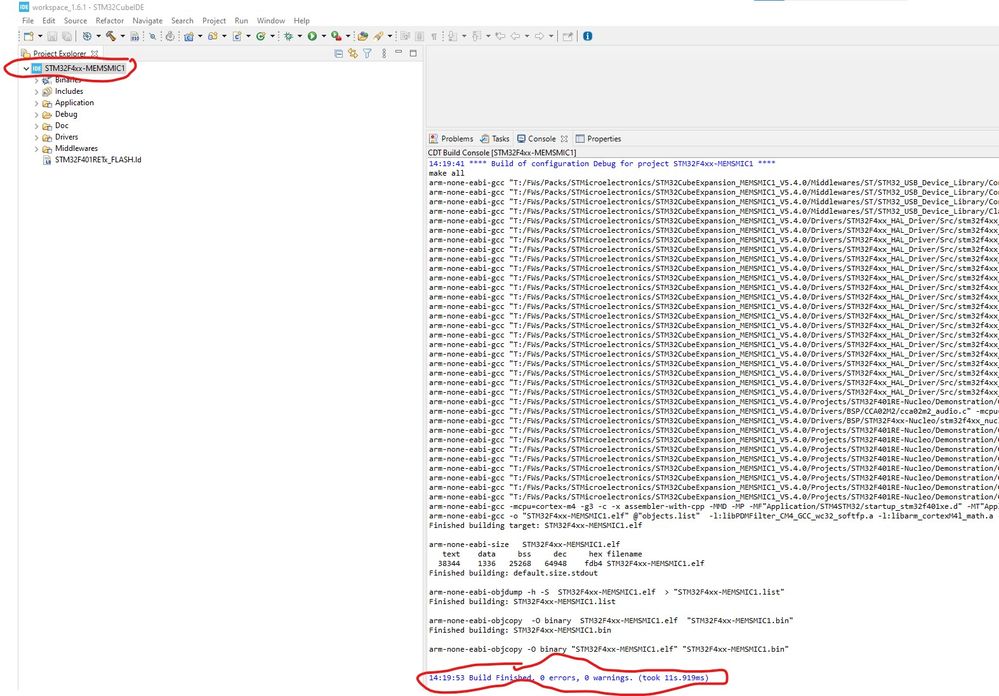

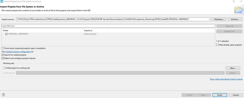

Rely on File > Open Project From File System
Takes care to promote right repository level: STM32CubeExpansion_MEMSMIC1_V5.4.0\Projects\STM32F401RE-Nucleo\Demonstration\CCA02M2\Microphones_Streaming\STM32CubeIDE\STM32F4xx-MEMSMIC1
Compile then. I'm getting no issue on my side if IDE 1.6.1 release at least
