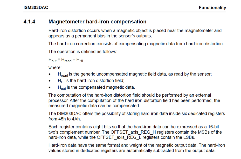

I am using ISM303DAC in my project E-Compass, I am facing an issue regarding hard iron calibration. in datasheet it is mentioned that we have do hard iron calibration using external processor and has to store those values in the internal registers of sensor. here i don't know how to do the hard iron compensation can anyone please let me know the procedure/steps to do the hard iron calibration if any example is available with you please provide me.

Hi @Anil3 ,
You can use MotionMC library to implement the hard iron compensation.
Here you can find the user manual, let me know if you have any other doubt.

Hi @Anil3 ,
In most applications it is necessary to recalibrate if environmental conditions change. it is not recommended to always use the same Hard Iron calibration values.
For compass applications we suggest the MotionEC library.

Hi @Anil3 ,
The magnetic calibration algorithm is used to compensate for magnetic distortions in the environment around the sensor.
If conditions change such as the proximity of a magnet, the calibration is no longer effective. You need to redo the calibration.
