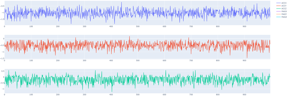

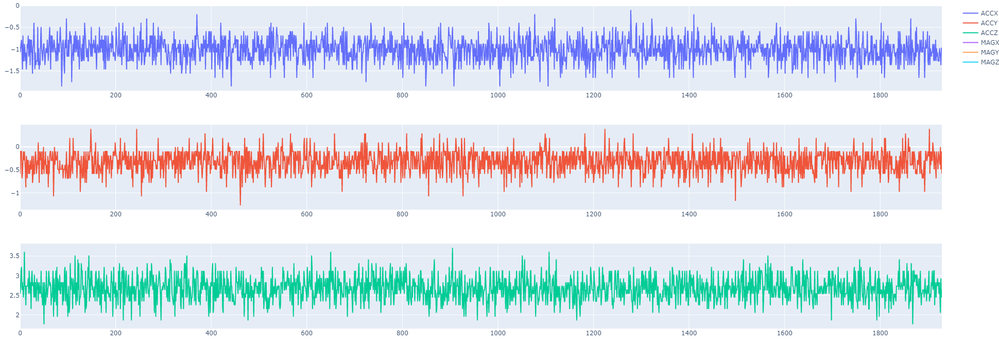

Below is a recording from a device with the high-G issue on the Z-axis. The device is in a static position on a desk and we're seeing the Z-axis with values of up to 4G. If we change the orientation of the device, the Z-axis still has this high G value.0693W00000HpafKQAR.png
This is what we're expecting to see - a noise range of less than 2G on all axis;
0693W00000HpafPQAR.pngNow for the confusing part - this value shifts over time. We are seeing devices with no G offset issue that passed QA testing have this issue after 3 months of just sitting on a shelf. We're also seeing devices that failed QA at 3G noise now have 6G noise after 3 months.
The high G value isn't just when it is static, the unit when moved in a controlled manner shows the Z-axis reading higher than it should in comparison to a device without the high G issue.
